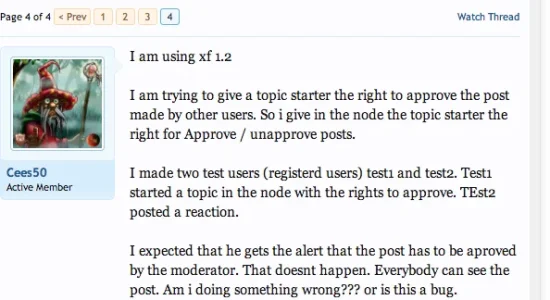

I am using xf 1.2
I am trying to give a topic starter the right to approve the post made by other users. So i give in the node the topic starter the right for Approve / unapprove posts.
I made two test users (registerd users) test1 and test2. Test1 started a topic in the node with the rights to approve. TEst2 posted a reaction.
I expected that he gets the alert that the post has to be aproved by the moderator. That doesnt happen. Everybody can see the post. Am i doing something wrong??? or is this a bug.
