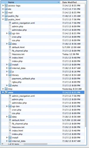

Your forum is currently installed in the root so should automatically work.
Do you have any index files in the root in addition to the XenForo files?
It sounds like your server isn't configured for or doesn't support FURLs, but the blank page from the root URL indicates another configuration issue.
I will check the details when I get home - I have it hosted using hostgator if that helps.
Make sure you haven't modified your htaccess. By default, HostGator has enabled
DirectoryIndex index.html index.shtml index.php default.html home.html
in the .htaccess.
If you deleted .htaccess, then it reappears as an empty file. This info was obtained from http://support.hostgator.com/articles/specialized-help/technical/apache-htaccess/-htaccess-guidance.
Easiest thing to do (and to enable friendly URL's) is to use the example one provided with xenForo. Just rename it .htaccess.

Make sure your ftp client is showing hidden files.
There should be an .htaccess file in the root with that content.
If there isn't, create it.
Just create the .htaccess file using the contents of htaccess.txt and upload it to your root.
