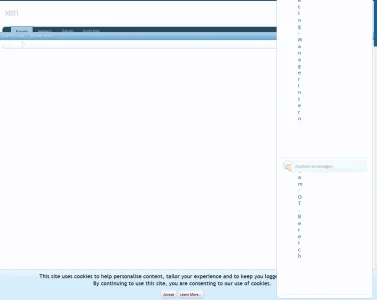

A au lait Well-known member May 11, 2018 #1 Affected version 1.5.20 Beta 1 / Beta 2 When a notification with a "floating" setting is active as well as the cookie hint, the output seems to be broken when viewing as a guest. must floting
Chris D XenForo developer Staff member May 11, 2018 #2 Thanks, there's a missing closing <div> inside the notices template in the floating notices section.

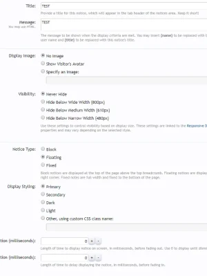

trapped_soul Well-known member May 11, 2018 #6 Chris D said: Thanks, there's a missing closing <div> inside the notices template in the floating notices section. Click to expand... Hi Chris, Is it the first set but last closing </div> that's missing? (3rd down) ? Fixed it. All sorted. No, didn't work on Edge. Last edited: May 11, 2018
