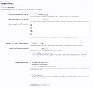

here is a screenshot of my attachment settings as well :-)

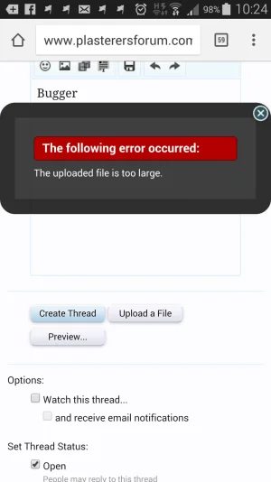

it just says file too large...

What was the exact error message word for word, or a screenshot? It has some relevance and may help us identify more easily in the code where the error is occurring.
Ironically, the actual reason for this is that your maximum attachment file size is too large.
I just clocked how big it actually was - too many zeroes to register it being a problem - but indeed, I reckon if you made it something reasonable like 200000 (which is still ~200 MB) it might go through.
