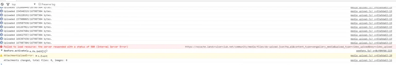

Error in Chrome console is:
Failed to load resource: the server responded with a status of 413 ()

Does XF itself give you an error in an overlay? If so what is it? What is the full output of the console? Usually it would indicate which resource failed to load. You can screenshot the console if it helps.
Exactly at which point do you get the error?
@Chris D

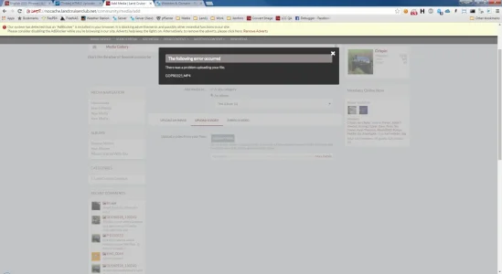

All I get from XF is the overlay saying something went wrong. See below
It gets all the way to the end (as confirmed in the console bytes-sent) and then dies.

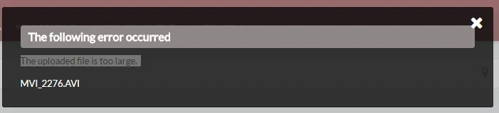

Now, all I get is a nice clean:

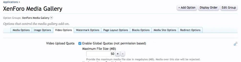

That, I suspect, is a XF setting somewhere. Odd thing is, I have no limits set in the RM video options. This file I uploaded was 380MB. Might I be missing a setting somewhere?
CloudFlare:
This is a no go :( The only way to get around it is to stream from and upload to a sub-domain. Don't suppose anything like that is supported in XF?
RM or MG?
If that option is checked then the maximum file size value comes from there.
If that option is not checked then the max file size comes from the permission system so you would need to investigate that by looking at Analyze Permissions for the affected user/s.
Spot on - it was (default?) 100MB for registered users.
