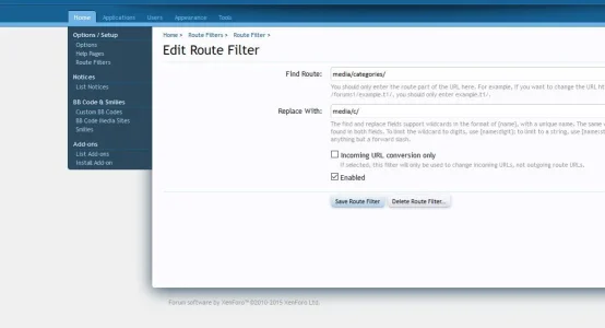

dotpro Active member Dec 29, 2015 #5 Mike said: There isn't a reason for media/categories/ -> media/c/ to not work, unless you already have another route filter that is matching the URL in question. Click to expand... This is the 2nd route besides the default that comes with the xmg. attaching route setting screenshot Attachments route-filters.webp 34 KB · Views: 10 Upvote 0 Downvote
Mike XenForo developer Staff member Dec 29, 2015 #6 Ahh oops. Do xengallery/categories/ to media/c/ . Upvote 0 Downvote
