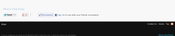

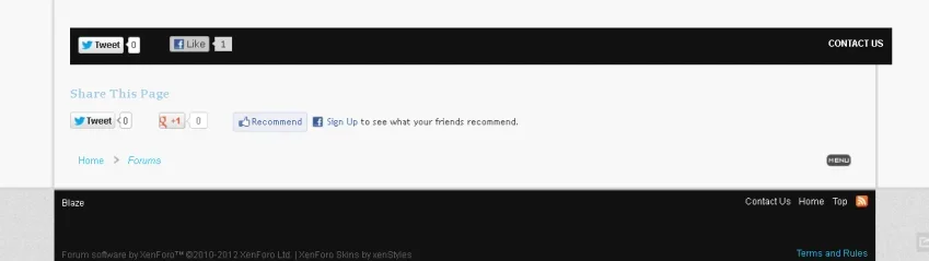

I'm using the page node for my landing page. I'm using it so that can I have the navbar and signin/login within the forum framework. However, I would like to either remove the forum footer and use my own html and css for it, or move/remove the following:
  1. remove "share this page"
  2. move the twitter, facebook, google buttons into the forum footer
  3. remove the style selector
My preference is still the first, removing the forum footer and using my own.
Can someone give me the "conditional" to accomplish either one of the two options, if that's what would do the trick? I'm guessing the code would have to include the node id so that it only applies to the landing page but I really don't know how to write that out.

The footer itself is a template. You could create a new style with a different footer and assign that style to the page node.

It seems to me customizing a whole new style just to move or remove the soc. media buttons from the landing page is a huge undertaking, especially since I already have a customized style that I'm using on the forum, and the page node was designed to match that style with html and css. The problem is that it inherits the footer from the forum and includes the social media buttons in the page content, which I believe pushes the navbar out of alignment at the top.
I suppose one way would be to duplicate the existing style with another name and just change the footer in that style. The only problem I see with that is that when someone signs into the forum the reverse problem will exist. Now the forum will have the same footer as the landing page. This will have duplicate sets of soc. media buttons (one set in the right column the other in the footer). The whole point of this exercise is to move the soc. media buttons into the footer on the landing page. Or if possible eliminate them from the page altogether.
I'm really having a problem wrapping my brain around this. It just seems terribly complicated and I'm really not sure it will work.

The new style can be created as a child of your currently customized style. Then it will be identical except for further customizations that you make, such as to the footer template.
Or yet another approach would be to use CSS to set display: none; for a specific element within that page node. There are examples given in this thread showing how you can use the body class in the beginning of the CSS selector to target elements within certain node_ids:
http://xenforo.com/community/threads/set-different-body-background-for-each-forum-css.24511/

After I typed the above I think I finally got a clue as to what you meant when you said "assign that style to the page node."
That means it will only apply to the page node, leaving the forum style as is. Correct?
Okay, I can try that. Unless you think setting the display: none; would be a simpler solution?
