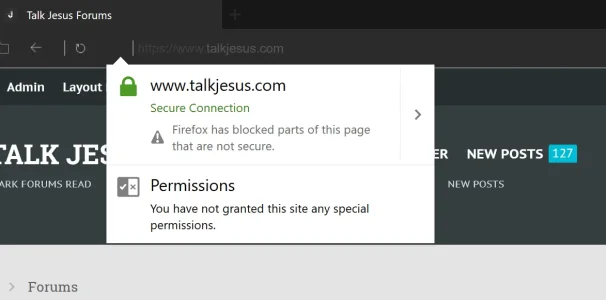

Problem is https://www.talkjesus.com/ shows insecure page elements when viewing as guest. If logged in, it shows secured but "firefox has blocked parts of this page that are not secure" and icons do show fine.
The font awesome icons are the broken ones.
Admin access is secured 100% otherwise. Would appreciate help on fix this.

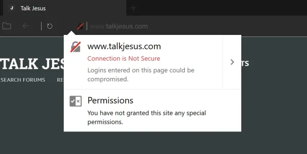

Hey Brogan,
Please see attached. Cleared FF cache entirely and restarted. Same error as guest, and partial error as logged in user.
Regarding the CSS:
http://code.ionicframework.com/ionicons/2.0.1/css/ionicons.min.css
How did you find that it was the specific culprit? What tool did you use? Thanks for the find as well, updated it and that fixed the partial error when logged in.

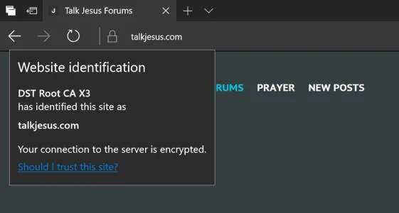

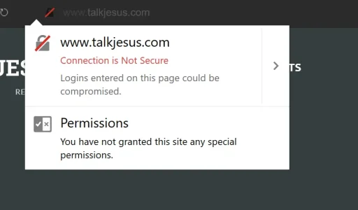

Here's what I noticed below (I still prefer any non https direct access be redirected to https automatically, site wide which I'm asking for help on here and haven't gotten a solution).
If I go directly to talkjesus.com (without "https" protocol) in Edge browser, I get no error (attached pic).
In Firefox, I get this error. Is this just a new Firefox warning for non https page(s)? Never seen this before prior. Running FF 51.
