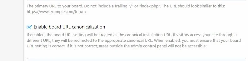

I noticed an interesting and helpful option in Xenforo that I didn't see the other 50 times I've looked at that screen. It's probably a feature of 2.0.
It sits below the Board URL field under Basic board information. (I ticked it)

XF2 also has a canonical setting in the ACP which should be enabled.
