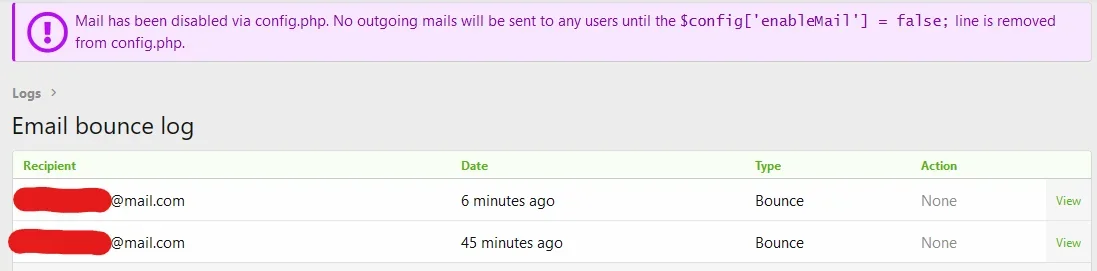

Finally got around to putting it to the test...
In short: the email bounce handler does run even when email is disabled.
See pic below... (At first, I manually triggered the job, and then realised that for completeness I should let it run by itself. Both runs fetched a bounce.)
I'd rate the chances of this "breaking"* bounce handling for the live site as fairly low, if the cron job is activity-based and the live site is reasonably busy. However, I'll be disabling it for my test sites from now on, via the DB. (I used UPDATE `dbname`.`xf_option` SET `option_value` = '{"enabled":false,"type":false,"host":false,"port":false,"username":false,"password":false,"encryption":false,"oauth":false}' WHERE (`option_id` = 'emailBounceHandler');)
