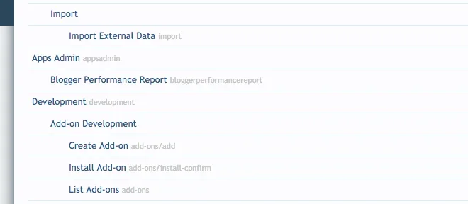

1. I am wondering why am I not seeing my "Blogger Performance Report" link in the sidebar?
What's missing?[/code]
"Blogger performance report" is what you can't see? "Apps Admin" is visible. What's the navigation link info for blogger performance report? Did you tick the 'hide this navigation when there are no viewable children' on it?

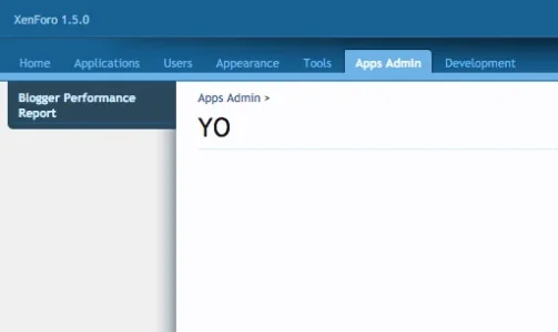

Well, I do see 'Apps Admin' at proper location. However, when I click on it, I see the contents (sidebar and main panel) from the 'Home' tab. I'd like to see my own left sidebar that lists "Blogger Performance Report" and the main panel should load the contents from my template.
Oh, right, you're just not seeing the sidebar options. You use a template or something for that, never played around with it so I'm not sure where you set that. Take a look at XF code for the Applications tab or something.

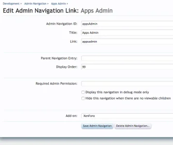

You set it in your route as the third parameter in $router->getRouteMatch. Looks like his is already though. If you want to export the add-on and send me the files I can take a look for you @TheBigK
The third parameter of getRouteMatch ("appsadmin" in your case) should match the ID of the parent navigation entry that should be activated. Therefore, the navigation ID of your "Apps Admin" navigation should be "appsadmin" rather than "appsAdmin" (or the third paramter of getRouteMatch should be "appsAdmin" instead of "appsadmin".
Ooh, good catch. Didn't even notice that, was looking at the screenshot of his route prefix configuration and saw that they matched didn't notice he had one of his navigation configuration too
Wow! That got the job done!
