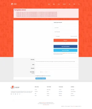

The first question: I am currently trying to display the content of register_form on a different page. (So that people can register on another page where they also have their login). So I simply tried to copy the code of the register_form file into my _page_node, but unfortunately I had to notice that problems occur here, but sadly I don't know how to fix them either.
Here is a picture of the error code:

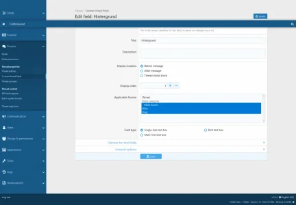

Second question: I am trying to create a custom thread field. Works the way it's supposed to. But it is possible to (1) create a custom display location (not before a message, after a message or in the thread status block) (2) upload an image as a field type (something like the type if you upload an avatar, so with maximum size etc.)
Screenshot-2018-3-29 Edit field Hintergrund Craftonia net - Admin control panel.webp

I've searched a bit in the code and it seems so that the variabels are just available in the register_form template file.
{{ $regForm.getFieldName('username') }}
{{ $regForm.getFieldName('email_hp') }}
{{ $regForm.getFieldName('email') }}
{{ $regForm.getFieldName('password') }}
{{ $regForm.getUniqueKey() }}
{{ $regForm.getFieldName('timezone') }}
How can I make these variables available in an other page?
