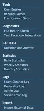

AndyB Well-known member Jan 20, 2014 #1 I would like to add a link called Search Log to the admin control panel sidebar. The link would go into the Logs area. Is there a way to do this? I would like to add this to my Search Log add-on. Thank you.

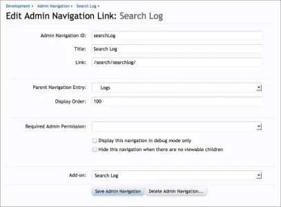

AndyB Well-known member Jan 20, 2014 #3 Thank you, Paul. I was able to add the link, but I'm having trouble adding the correct URL. Here's what I have now: The URL points to: http://www.southbayriders.com/forums/admin.php?/search/searchlog/ The problem is I need the URL to point to: http://www.southbayriders.com/forums/search/searchlog/ Is there any way of doing this?
Jeremy in memoriam 1991-2020 Jan 20, 2014 #4 Admin links are meant to only point to areas within the admin CP. You'll need to write an add-on that will override and add-on.
P Paul B XenForo moderator Staff member Jan 20, 2014 #5 These links are purely for admin navigation. They aren't available in the front end. Have you considered moving the log to the ACP?
