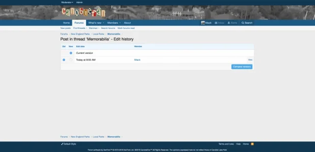

Just now on my forums, when I clicked on 'History' (edit history) of a member's post, it opened a new page. It did it 3 out of 4 tries.

Can’t reproduce that here. I’d check to see if there are any errors logged in the browser console that coincide with clicking it and also try it on an unmodified default style.
Note that because XF2 loads its JS in the footer it’s sometimes possible to activate certain things before JS has fully loaded and so stuff like this or overlays can open fully rather than through an AJAX request.

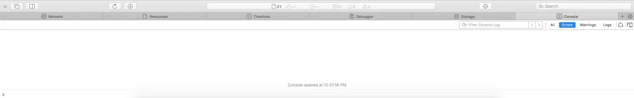

Thanks, Chris. I have no browser extensions installed. My default style has very few modifications; just one entry in extra.less and 2 add-ons. I don't usually click on 'History' too often, so I guess it's not a huge deal. I found "Show JavaScript Console" in my Developer menu. If I'm reading it correctly, there are no errors. Not sure if that is the only console to check.

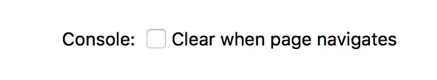

That's the correct console, though it may clear itself when you load a new page. To solve that, click the cog icon (to the right of the Console tab) and ensure this is checked:
Also keep the console open when you try it again.

I just tried what you suggested. That box was checked already. No errors reported.
