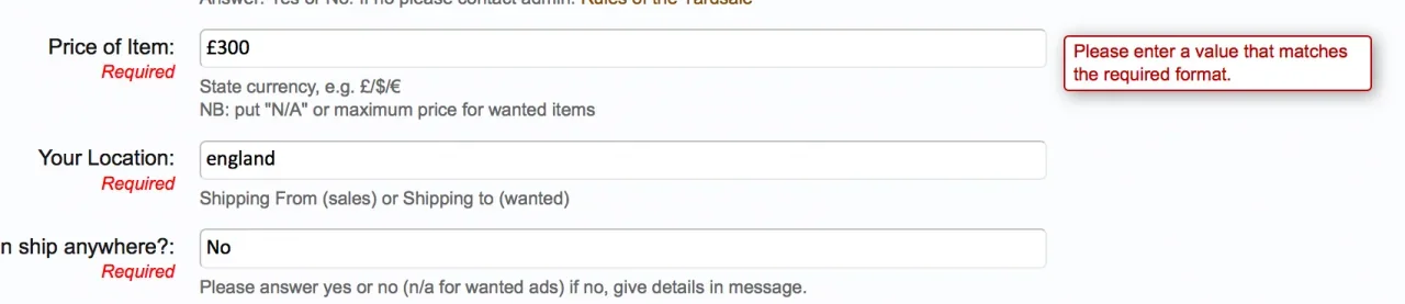

What I want is to match the value so a user must put in a currency symbol and amount
I can do this with a specific currency, e.g.
^\£(\d{1,3}(\,\d{3})*|(\d+))(\.\d{2})?$
for £
However I want to allow $ and € as well (or ideally any currency symbol)
Can someone please help with this?
Thanks
Update, yes, it tests fine, but just doesn't accept any currency symbol except $ when I try it live.

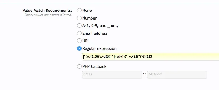

Tnaks, but that one doesn't seem to work either. The examples work at regex101, but not when I use for a match in a custom field on xenforo.

OK, I think I know the reason is it took a while for the cache on the site . So it is now working, thank you very much for that.
I have one more question about this.
How would a make an expression that requires either the £,$ € symbol OR a percentage?
So £20, €20, $20, 20% are all OK, but not 20.
Thanks
Thanks
^(£|\$|€){1}(\d{1,3}(\,\d{3})*|(\d+))(\.\d{2})?$
This should require a symbol, I don't know what do you mean by requiring percentage?
Edit: Now I see what you mean, you have to add another regex match for the percentage like this:
^(\d{1,3}(\,\d{3})*|(\d+))(\.\d{2})?(%){1}$
So your PHP code should look like this:
PHP:
$pattern1 = '/^(£|\$|€){1}(\d{1,3}(\,\d{3})*|(\d+))(\.\d{2})?$/';
$pattern2 = '/^(\d{1,3}(\,\d{3})*|(\d+))(\.\d{2})?(%){1}$/';
if(preg_match($pattern1, $price) || preg_match($pattern2, $price))
    // Your code
How would I have two reggae matches for one field? I didn't know that as possible, so I wonder if it is possible to have one expression that covers currency symbols and the % sign?
Thanks
Thanks
Check my reply again, I have explained it with a PHP code.
