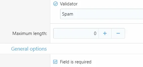

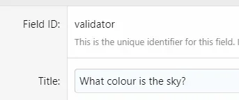

Create the custom user field and set the options like so:
Then create the following file in XF\Validator\Spam.php:
PHP:
<?php
namespace XF\Validator;
class Spam extends AbstractValidator
    public function isValid($value, &$errorKey = null)
        if ($value != 'blue')
            $errorKey = 'Invalid entry';
            return false;
        return true;
You can expand the if check to allow for capital letters, or use regex, etc.

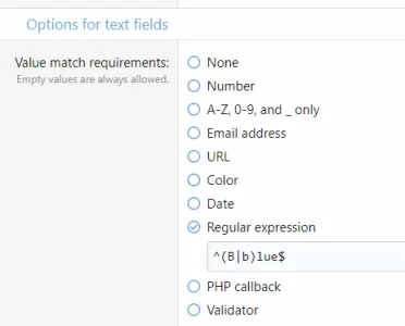

If you want members to able to answer Blue or blue, use this regex:
PHP:
<?php
        if (!preg_match('/^(B|b)lue$/', $value))
            return false;
        return true;
However, for a simple use case such as that, I would just go with the regex option directly:
