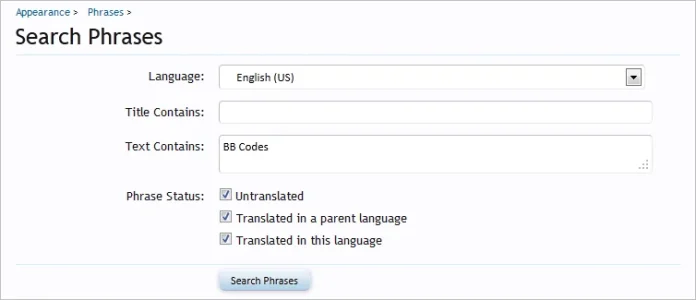

Oh I couldn't find the phrase to edit phrase BB codes in the Help menu and dropdown.
Would like to to be How to Edit Posts.
Search the actual phrase content like so:
That returns three phrases, bb_codes is the one you want.
I dunno what went wrong Brogan. I tried to do that before. Anyway your help meant I felt reassured and tried again.
