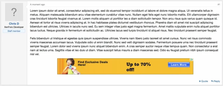

Result:
The main differences are:
  • You don't need the user_id check, as there are checkboxes on the edit advertising page to show/hide the advert based on user groups (if you did, then the correct syntax would be $xf.visitor.user_id.
  • <xen: has become <xf:.
  • $xenOptions and some other "global" template params (like visitor) are now in the $xf namepace, e.g. $xf.options.
  • In some contexts, such as the conditions, you no longer need the curly braces.
Obviously the styling was thrown together, you might want to do something different.
