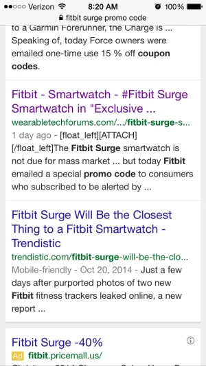

XF 1.4 Googlebot Can See My BBCode
Similar thread here by @CNK
The root cause is due to BBCode tags appearing in the truncated opening post for the meta description.
Consider a thread with just an embedded image or an attachment.
If those tags were stripped completely the content would be blank.
The float_left thing is weird so I need to check that, but the explanation with the attach placeholder is correct and is most definitely as designed. You will see this anywhere we do a plain text representation of BB code content.
float_left is a custom BBCode.
Then you can edit the files as suggested in the other thread, or have an add-on developed.

As more and more people have troublesome BB Code in Meta Description, so you may want to add an option to choose remove all BB code from Meta Description?
I do not think anyone posted topics with the same images without any content...
