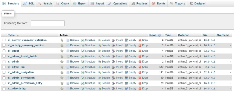

All my tables are currently utf8mb3_general_ci

For some weird reason, the collation of all the tables went to utf8mb3 and running the
cmd.php xf:convert-utf8mb4
had no effect and returned that no convertable tables were found.

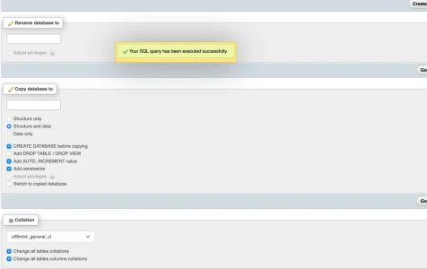

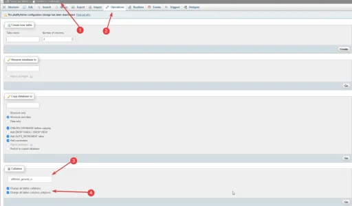

I managed to fix the issue by setting the collation of the entire database to utf8mb4 through phpmyadmin.
  • Select the xenforo database
  • Go to 'Operations'
  • At the Collation, choose utf8mb4_general_ci
  • Select 'Change all tables collations' and 'Change all tables columns collations'.
  • Execute

I used phpMyAdmin to change the collation and it worked great, I used the steps shown in post #8. Keep in mind that this takes only a few seconds and there's no feedback.
Correct. Of course I didn’t have that information at the time of the post you quoted.
Yup--I only recently became aware of this change, and it's far from obvious what's happening. Fortunately, it's pretty easy to adjust XenForo in this case.
Some add-ons may introduce case-sensitive columns, and they will become case-insensitive if you take this approach. You should double check that you don't have any columns with collations other than utf8mb3_general_ci before running that command. If you see utf8_general_ci, this issue doesn't affect you and you should run php cmd.php xf:convert-utf8mb4 or remove the fullUnicode line from your config.php (ideally the former). If you see anything else, it's probably best to wait until xf:convert-utf8mb4 is able to handle utf8mb3, as that's the safest way to ensure nothing breaks. You can safely ignore the error for now if you see utf8mb3_general_ci instead of utf8_general_ci.

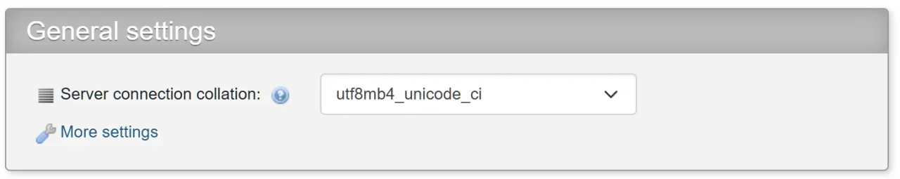

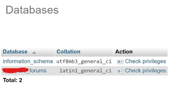

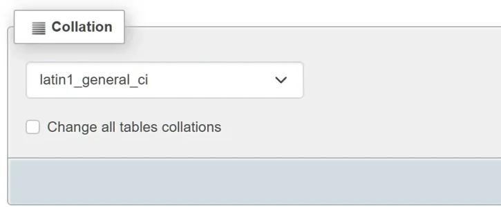

It came as well our turn for this message!
I follow post #8 instructions but i found some differences and i didnt proceed...
So, at phpmyadmin panel all tables are "utf8mb3_general_ci" but at the bottom of the list has also the "latin1_general_ci".
It is correct this?
Entering in operation section the collation is "latin1_general_ci"!
Should i proceed modifying the collation or not?
Thanks for any help and sorry for my ignorance!
