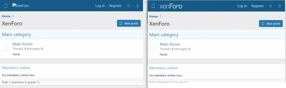

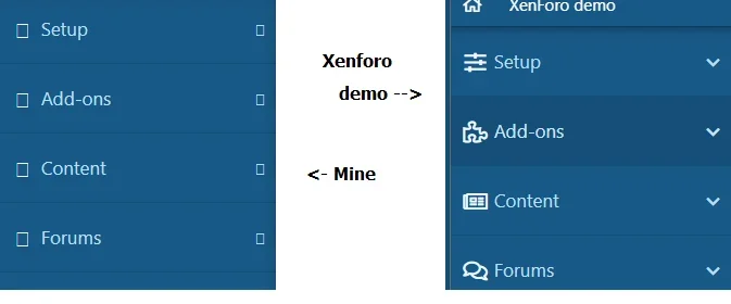

No icons/images appear in the acp or on front-end.

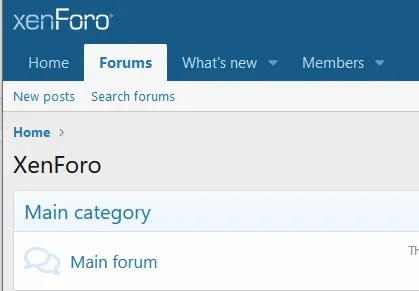

I've checked the licensed URL and the front end looks ok (though the forum is closed so I can't really browse it). Some of the arrows come from the same font file as those icons.

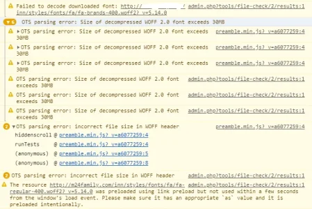

If that comes up ok, you may need to check your browser's developer console (in their dev tools) to see if it gives any further details on the error.

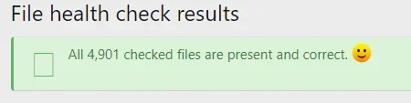

File health check reports no problems...without the checkbox icon/image.
The Xenforo demo health check shows 5,404 files. My install shows 4,901.
Is 4,901 the correct number for a fresh install?

Brave's dev tool console provides the following:
progress...now how to resolve?

I can only suggest that this is something that might be specific to your end, as I have tried Chrome, Edge and Firefox without issues in any of them.
I notice the logo image doesn't even appear to load in your Brave screenshot. That's just a basic PNG file and could potentially be related.
