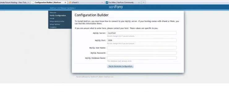

I received this from my host
Please accept my apologies for the delay. We had a few issues trying to figure out what was wrong. It seems to us that there is a flaw in the script. We have had to manually edit a few of the php files from the script in order to remove the errors. We have included the exact path of the script in the php files. This is a small work around but I suggest that the people who create the script look in to how they include files in their php scripts. It would be much simpler for them to use exact paths.
At least now the install starts and gets as far as asking me for database details
MySQL Server: localhost
MySQL Port:3306
asks for
MySQL User Name:
MySQL Password:
MySQL Database Name
which i put in and then i hit the test and generate configuration and it crashes
Fatal error: main() [function.require]: Failed opening required 'Zend/Db/Adapter/Abstract.php' (include_path='.:/usr/lib/php:/usr/local/lib/php:/home/xxxxx/php') in /home/xxxxx/public_html/Zen/library/Zend/Db/Adapter/Mysqli.php on line 550
