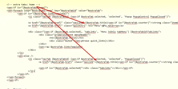

You can edit the navigation template and look for the {xenhrase home}, replace it with Font Awesome code:
Code:<i class="fa fa-home"></i>
Did you edit the right template in the right style? Make sure you're editing the navigation template in your Flat Awesome style.This did not work for me. I changed it in navigation and quick navigation templates, reloaded, and it still says "HOME" in the tab.
<li class="navTab home PopupClosed"><a href="{$homeLink}" class="navLink">{xen:phrase home}</a></li>
<li class="navTab home PopupClosed"><a href="{$homeLink}" class="navLink"><i class="fa fa-home"></i></a></li>
Yeah, that might be the issue then. I'm not familiar with the add-on but it's quite possible it is adding its own tab to act as a 'Home' tab hence why the changes we advised you to make are seemingly having no effect.Yes I quadruple checked that it was the navigation template in the currently active style. It still showed "HOME" typed out. Note I do use CTA featured threads as my home page and don't know if that affects anything.
I can't seem to find that template. Can you tell me which one it is? I dont have a template called extra tabs.He's probably using the extra:tabs home
Try placing the font awesome icon on those spots.
