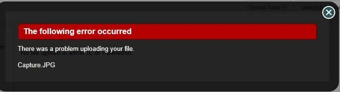

We have just upgraded to PHP 5.4.15 and it seems that the only thing to have stopped working is the Flash file uploader. Whenever we try and upload in FF, we are met with this error:
No error is logged for this, in the ACP.

My issue is identical to the OP, the photo loads up (the progress bar gets to 100%) and then I get the "problem uploading your file" pop up.
