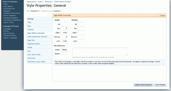

sorry, I still do not understand how to change a "fixed width style" in becoming "responsive".
This is the setting I had with XF 1.1.4
Could you please let me know what I need to change in order to turn my fixed-width-style into "responsive" ?
I am actually using the default XF-style, I have just altered a few colors and some CSS in extra.css for some style-elements.
Appreciate your help!

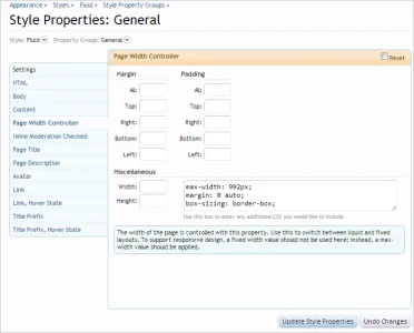

If responsive design is not working, check the following elements of Style Properties:
  • General -> HTML - ensure there is no min-width specified in the Miscellaneous field; if there is, remove it
  • General -> Page Width Controller - ensure there is no min-width or width specified in the Miscellaneous field; if there is, change it to max-width
  • Responsive Design - ensure Enable responsive design is checked

You have a fixed width specified.

I thought the instructions were clear enough.
It's even mentioned on the page itself:
The width of the page is controlled with this property. Use this to switch between liquid and fixed layouts. To support responsive design, a fixed width value should not be used here; instead, a max-width value should be applied.
Just to add some further context.
In the configuration demonstrated above... max = maximum.
So we're saying the absolute maximum the width of the page can be is 992px;
That means if the screen is less than 992px then it will shrink down. Then responsive design does even more things, as I explained, such as turning the width to 100% (making it fluid) or moving elements or hiding elements.
