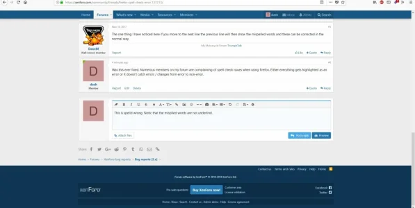

Was this ever fixed. Numerous members on my forum are complaining of spell check issues when using firefox. Either everything gets highlighted as an error or it doesn't catch errors / changes from error to non-error.
EDIT: Seems like it has not been fixed, I can replicate it here at Xenforo.com. Also noticed this was raised on Aug 11th.

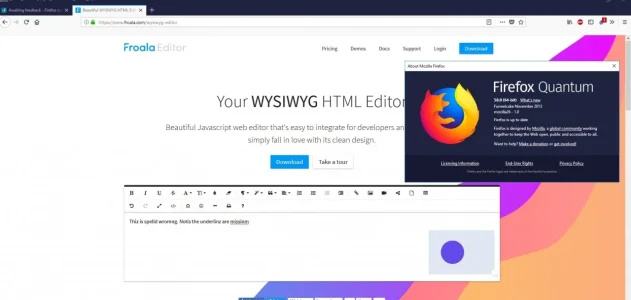

I'm using Firefox 59.0b3 and I cannot currently reproduce the issue, so we suspect that FF has fixed the original regression in the meantime. If you can still reproduce it, please let me know which Firefox version you're using (I'm not sure which version they'd have fixed it).

I'm back with 58.0 and I can't reproduce the issue.

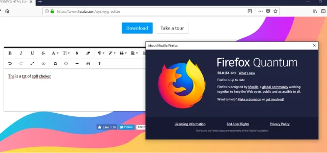

My test...
Win10 Pro, Latest Build... FF 58.0, No Addons/Extras. (fresh install of FF for this test)
Misspell a bunch of words. Then put 2 spaces after it and see what happens. Also misspell a bunch of words, then do a backspace. See what happens.
