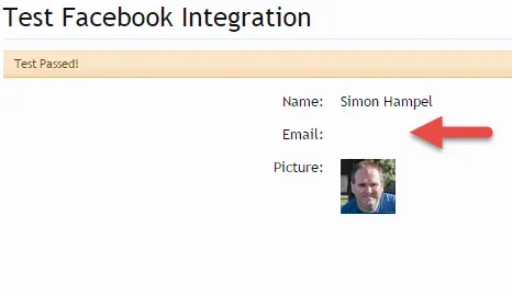

I'm hoping someone can help me troubleshoot Facebook integration for my site - when I test the integration it is not returning an email address.
I've done a lot of reading about this and most people point to not having a verified email address specified as your primary contact in your Facebook profile, but I've checked that and removed/re-added my email addresses several times to make sure it's not that.

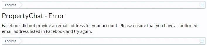

I also asked a few of my members to test the integration by trying to link their forum accounts with their Facebook profiles, but in every case they got the error about an email address not being returned.

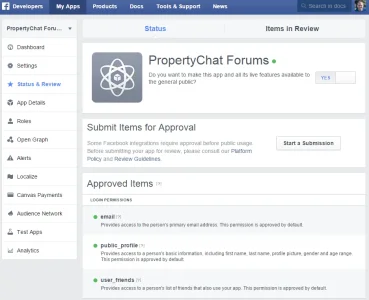

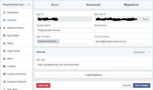

Here are my Facebook App setup details:

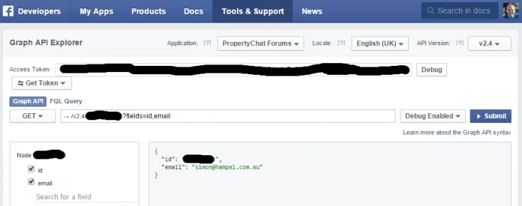

I read somewhere about using the Graph API Explorer to test whether the email address is returned correctly:
... which it is ...
... I'm at a loss as to what else to try to troubleshoot this issue.
