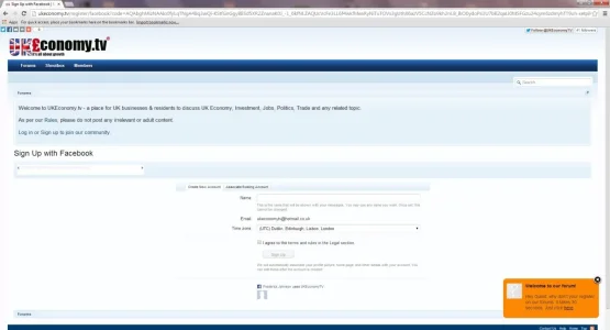

I have been testing my website's Facebook Connect. When you sign up via Chrome in FB it seems to work well – you sign up through FB and it takes you to the page seen in the photo below.
But, when you try to sign up via FB in IE it does not bring you back to the attached page – it takes you straight to the home page. So, in IE, you do not get to ‘Create a New Account’ or ‘Associate Existing Account’. (You only get to the attached page if you hit ‘Login with Facebook’ after you are taken to the homepage, after being brought back to the website from FB).
How can this issue be fixed in IE?

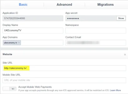

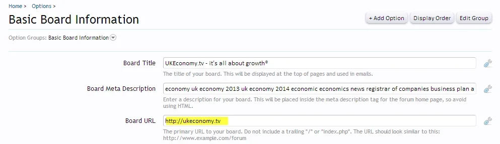

I cannot replicate this issue. Here's the settings from both FB and the forum itself, though. Could anyone verify that these are correct, please?
FaceBook:
Forum:
Thanks :)
It looks ok.
