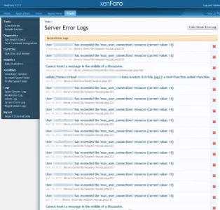

sforum
I have the same problem, and have noticed that my forum is very often sluggish, there are many double/triple-posts, time-outs, etc.
I just had a look at the server log and it looks like this:
Is this a XenForo problem, or something I should contact my host about? I never had any problems at all when running PunBB, even when I had hundreds of users on-site at a time. :confused:
Your host has set a limit of 10 concurrent MySQL connections, which you are hitting the limit on.
sforum
Thanks; I have filed a ticket with my host. :)

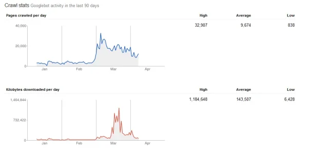

It's quite possibly you can't if you're on shared hosting - but usually you'd add the IP addresses of the spiders/bots to your firewall and deny them access to your server.
There's a Chinese one called Baidu that is quite agressive, and Google will often visit heavily if you've just migrated from another platform (you can slow Googlebot down by changing the speed setting in Google Webmaster Tools - at least for a short while until it's reindexed most of your content.)

CTXMedia
Formerly CyclingTribe
I wouldn't know about pagerank - mine didn't change - but when I initially migrated my server was being ground to an almost halt by the re-spidering. The blocking of Baidu and turning down of Googlebot's speed helped get over that initial hump, and as Google got caught up with my content I was then able to return the bot speed to normal. (y)
