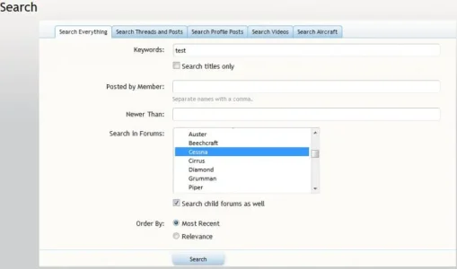

Enhanced Search isn't working for me due to a bug in the addon and which I believe has been confirmed by Mike

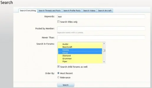

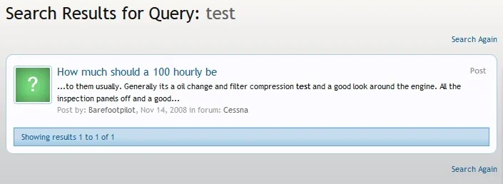

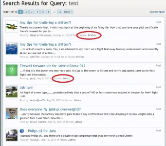

If I go to advance search and search for something in just one forum it works BUT if I search for the same thing in 2 or more forums then the search results show every forum on my site NOT just the two forums selected.
Here are some screen shots:

The bug seems specific on the newer versions of ElasticSearch.
The issue that I saw seemed to be specific to elasticsearch 0.90, but it's not an issue that I have confirmed on my own setups yet. If I can and it's an ES bug, it may need to be resolved by an upgrade there. Otherwise, it appears that it could be ignoring the conditions in this situation; at the very least, there's likely a regression in ES somewhere.
