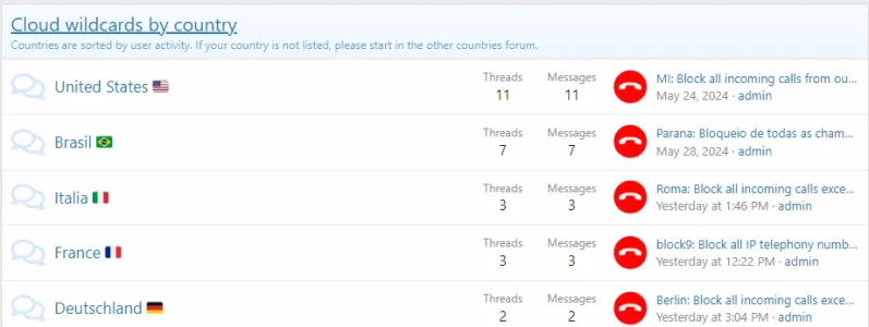

Hi everyone, I've discovered the following bug.
My forum names contain emoji (Unicode, country flags) and it works fine when using the standard database adapter
But recently I tried switching to ReplicationAdapter (XF\Db\Mysqli\ReplicationAdapter). Immediately after switching all the emoji disappeared and instead of them two question marks "??"
