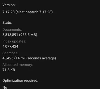

Running XF 2.3.6 and ES 8.17.4 and optimization runs fine for me. Maybe try rebuilding cache first through XenForo tools directly, it might be out of sync after and ES upgrade.
@JoyFreak Yes, there is a new default setting in ES that will prevent HTTPS working out of the box. It came out about a year or so ago. Let me pull up my settings, I think I notated it in there. Without the default setting change, you are correct that an HTTPS connection will not work.
Ah. so I just disabled this option "Use HTTPS connection" and saved it. I can now optimise and the search is working. Did I need to keep it enabled?

The key is this part:
# Enable encryption for HTTP API client connections, such as Kibana, Logstash, and Agents
xpack.security.http.ssl:
  enabled: false
  keystore.path: certs/http.p12
If you do not have certs installed specifically for this you must set it to enabled:false. This is likely the only change you need to make to get https to run once again for Elastic search. Prior to about 14 months ago this was not set to enabled:true as a default setting in ElasticSearch, which is why you never had to deal with it before.
Thank you :)
The only thing elasticsearch 8 did was use more ram for a insignificant increase in speed. Features you never need or can't even use aren't worth upgrading for. I'm guessing 9 is the same.
