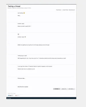

@Mike, I've taken the Core style down to this:
I've removed pretty much everything (header, footer, controls, userblock, etc) and emptied most of the CSS files and it still lags. If I switch back to the default theme then it's absolutely fine.
