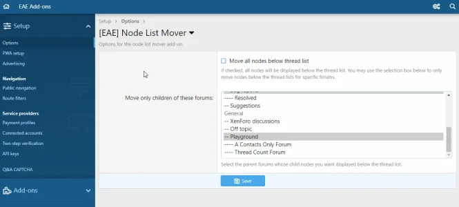

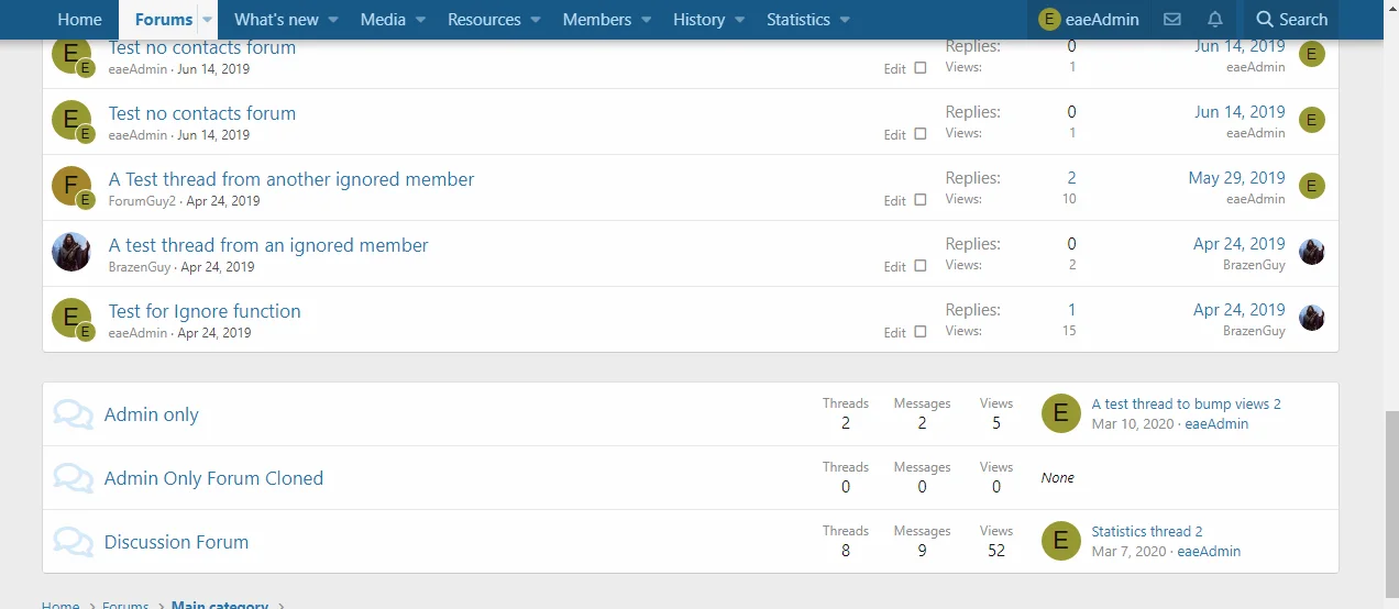

Under the General category, I selected that the forum Playground would have it's child nodes (A Contacts Only Forum, and Thread Count Forum) displayed below the thread list. The image above is how it was done, :), and you can see the result here on my site.

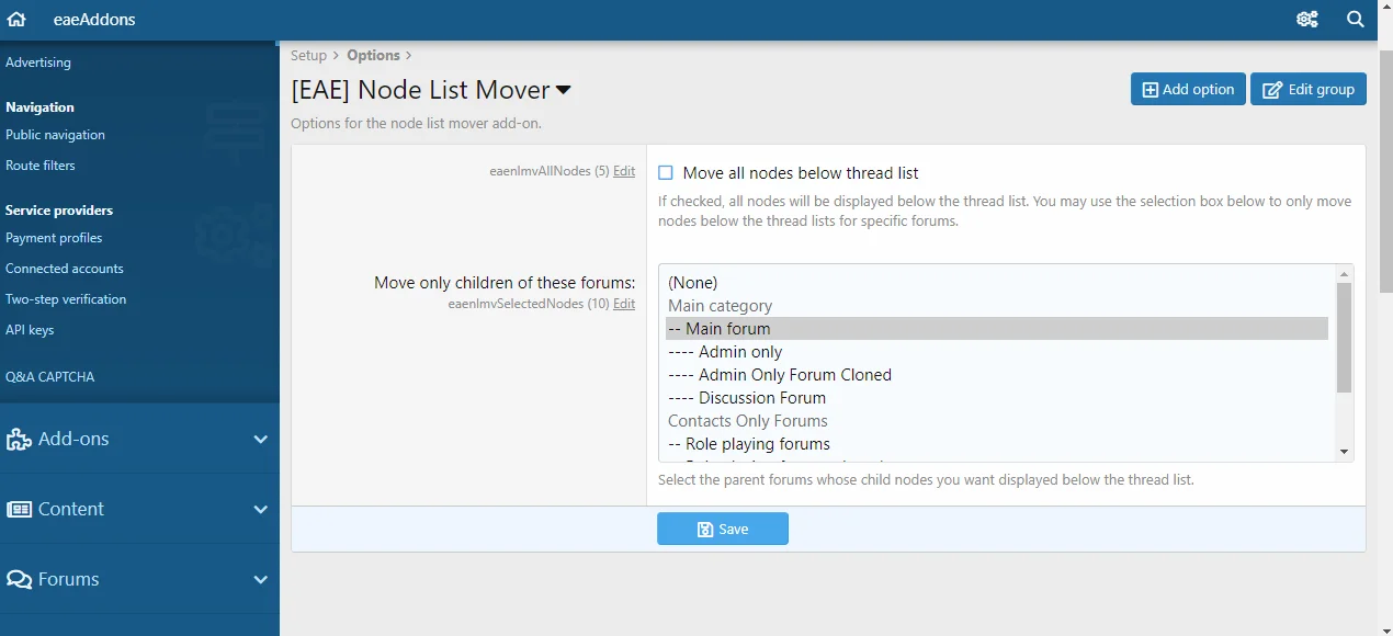

This is how is set on my forum. I forgot to mention that i have below thread view widget "similar threads"
