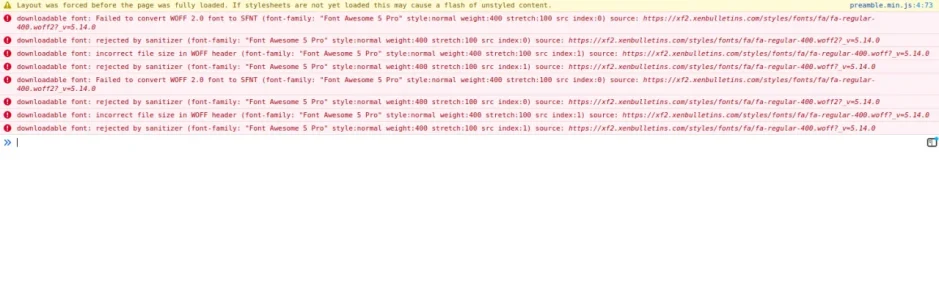

I have upgrade my test xenforo on rc2 it is on private directory (htaccess protected) . After i upgrade no font awasome icon is working getting this error on my console

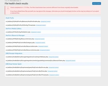

This very likely indicates that those files don't have the expected contents. You should run the file health check to confirm. They should be reuploaded if needed. If so, you likely need to check your FTP/uploading program to ensure that these files are treated as binary.
Alternatively, your web server may need MIME type settings so that it serves woff2 files correctly (there's some discussion here for Apache: https://www.thewebflash.com/set-the-correct-mime-types-for-woff-fonts-in-your-web-server/).

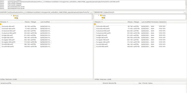

i uploaded this files again with treated it as binary still i have issue
Does the file health check report issues? If not, then it seems quite plausible that there's a MIME type issue (though this doesn't seem like it'd be something that's specific to 2.2).
