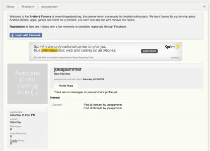

This was very helpful. I worked from this and modified my conditionals throughout member_view.

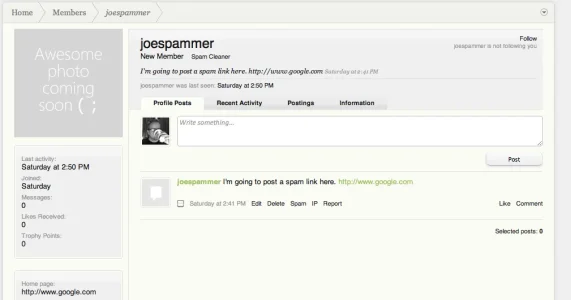

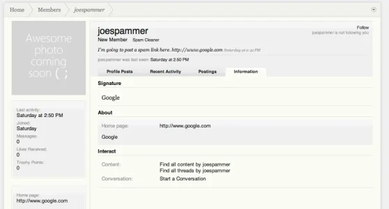

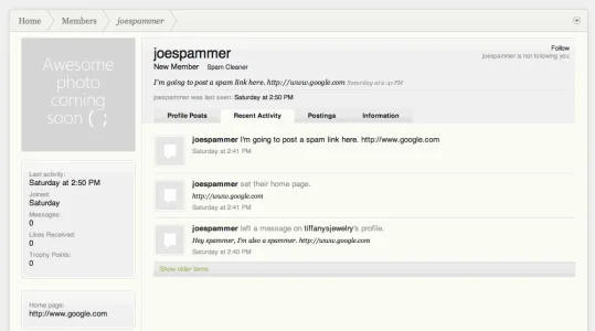

Here's the end result. Keep in mind, this is an example of a spammer that "I haven't found". The first image shows the current modified guest view. The following three images show all the links only seen by members.

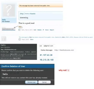

I just migrated another vB site to XF. My first new user was a spammer who set up a shiny new profile pic, status update complete with a spam link in the homepage field. While signature links are easily detected, it's impossible to check every new member's account to see if they simply signed up to spam.
I got one of those !
