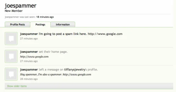

Thanks. I am oh so close to getting this right. I created a test spammer and placed links in homepage, status, signature and posted on another users profile. The conditionals I've set up have all but nuked the typical spammer's attempts.
The only trouble I'm having is with news_feed_page_global.
I must be placing the conditionals incorrectly.
Here's the last area I'm try to block. Do you have any recommendations on where in news_feed_global I should place my conditionals?
cmeinck
The news_feed_page_global template is for Recent Activity: http://xenforo.com/community/recent-activity/
Your screen shot above is for the member_view template.
Try adding the conditional to that.
I just cannot seem to figure it out. Here's a link to this ficticious spammer. Despite spam throughout this profile, profile posts, homepage, about, status -- for the most part, it's not viewable. The only tab I'm having trouble with is the Postings area. A quick look there and you'll see that despite my best efforts, the spammer is still successful.
Do you have any specifics you might share on how to remove this piece from guests?
Thanks again for all your help.
Brogan
XenForo moderator
Staff member
I'm a bit confused as to what it is you're trying to achieve with the Postings tab on profiles.
Do you want to just make them not visible to guests?
In which case you can do that with the View user profiles permission.
If you run the Spam Cleaner on the spammer and delete their content then everything on that tab for the spammer in question will be deleted.
