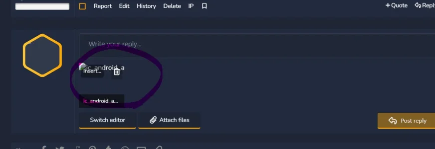

Hi my attachments not displaying the images, where can I start looking to troubleshoot, please

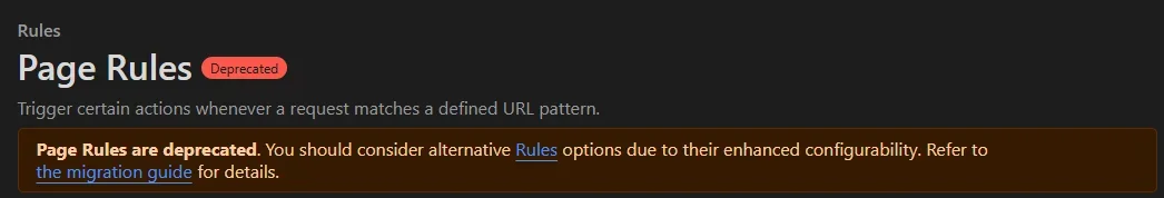

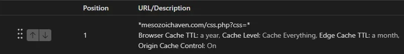

I believe I used a tip or trick via this thread or the addon, I'm not 100% but 99% sure, but Page Rules are going away apparently?
Anything I can do to replace the CSS caching I have with your addon?
