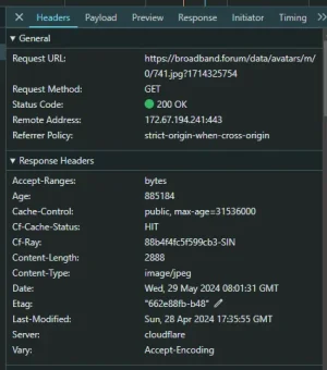

I am not using the R2 component of the addon but I had to make the file edit mentioned here. Without this, I was getting server error log entries on 2.3 betas. No other issues since then except that Percent cached in cloudflare graph has dropped down quite a bit. From 70%+ to 20% despite most settings remaining the same. I am not sure if this is due to webp conversion or some other change in 2.3. I do notice that some images that are webp are listed as jpegs (content-type) in networking panel on devtools at some places. Profile images mostly which continue to retain jpeg file extension but that should not be causing so much drop in percentage cached lol. Icon is missing in the admin side panel for the addon listing. And some settings do not appear to process like the ones with checkboxes.

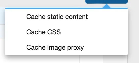

right. happens randomly. any plans to add an icon for the sidebar 🙂? i do not even remember how it was on 2.2. but it has been missing on betas. thanks!
Nothing change with that, and when I tested it, it's working as expected for me. Do you have any errors in your browser console?
