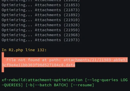

When rebuilding the attachments in 2.3 to
Optimise them, it causes the process to stop if a file is missing
I suspect that’s going to be the same with or without R2. A missing attachment file (even if it’s in the local filesystem) seems like something you would wand to halt the process so it can be addressed instead of ignoring it and moving on/skipping it.
Yeah, I suppose so. I know that attachment is missing because of the optimize attachments plugin that started randomly deleting attachments.
