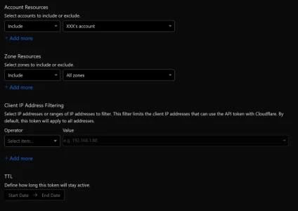

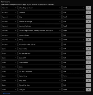

Assuming the settings page still is giving you an error, but you are able to verify the token with that curl command at the same time, the only other thing I can think of would be if certain individual API calls were having an issue. Maybe double/triple check your API token permissions? Maybe one of the permissions it needs was removed or edited. You need exactly these permissions:
Anything missing or anything with the wrong permission (like Read instead of Edit) will be problems.
Yeah, everything is exactly like that.
Stupid question, but not sure what else to look at... maybe try setting the limitation you have set to a specific account (Account Resources) to instead be "All accounts"?
Yeah, still doesn't work unfortunately. I even tried deleting my domain on CF again and re-doing everything and still doesn't work.
If it's a brand new domain (sounds like it if you are just deleting it and readding it), maybe wait a day or two... I haven't experienced it firsthand, but I'd seen random blurbs where API access is weird on new zones for the first 24-48 hours.
Yeah, so I messaged Cloudflare and asked them to completely remove my domain's configuration from their servers so I could start fresh again. Finally, they did and I redid the whole process. New name servers, new API token, entire configuration is default.
I still get the same error as before. I'm just gonna have to uninstall this add-on and manage everything from the Cloudflare dashboard, because I can't get this add-on to work.
