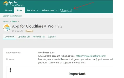

what about a help manual ?
would be easy to make (for you).
would look super reassuring for purchasers to see a manual.
users could help keep the documents up to date.
Ehhh... I've always been more of the mindset that if something I built needs a manual, it's not good enough and improvements should be made so people aren't needing to read through documentation.

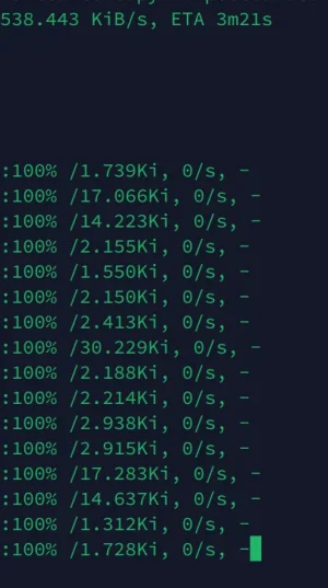

Has anyone here already transferred a TB of /data/ files to R2 using rclone?
It's very slow for me, and I think it's being rate limited.

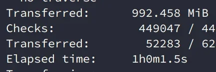

Where in the world are you? I know there has been some speed issues with R2 in some areas of Europe lately.
On the first run, for the first 1-2 minutes, I can maximize my outgoing network speed, which is 1 Gbps, before the slowdown begins forever.

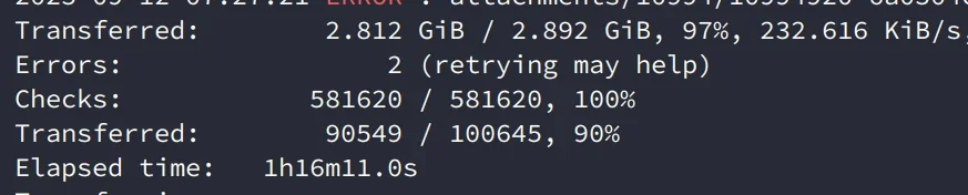

I run the same command from an identical copy on a remote backup server located in Utah, US.
Got similar speed; this server is capable of 1 Gbps outgoing also (different dedicated hosting).

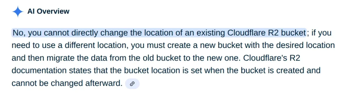

If you log into the Cloudflare dashboard, go to R2 (it’s at account level, not zone level), then click the bucket and then go to Settings for the bucket, what’s the “Location” set to?
Can this be changed to another location after the bucket is already created?
Edit: From google search AI :|
No, it can't... the only option is to create a new bucket with a specific location called out (by default it just uses "auto" which tends to put it close to your server).
