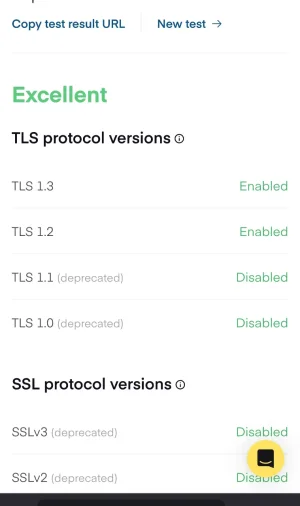

@Matt C. one thing that updating old versions of cURL will give you is support for newer TLS versions. As an example api.cloudflare.com (and most modern sites these days) have disabled support for SSLv2, SSLv3, TLS 1.0 and TLS 1.1. So if your version of cURL doesn't supports TLS 1.2 or TLS 1.3, you are basically out of luck because modern sites will refuse to communicate.
See:
The error you posted looks like cURL is trying (and failing) to make a SSLv3 connection, which isn't supported by Cloudflare API (or most other sites these days).

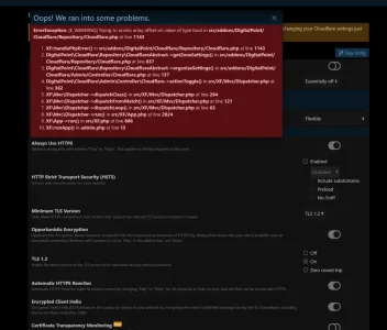

I have been noticing some erratic behavior from the setting page:
I was trying different settings in the Cloudflare Dashboard. This happened when I turned rocket loader on to test its effects. Turned it off, and the setting page loaded just fine.
Now I tested another setting related to SSL/TTS and got the error again.
Yeah turned it back off after reading your optimization thread.
Regardless settings page won't load anymore and its stuck on that error message.

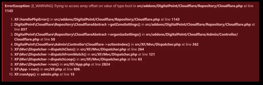

Slightly different:
ErrorException: [E_WARNING] Trying to access array offset on value of type bool in src/addons/DigitalPoint/Cloudflare/Repository/Cloudflare.php at line 1143
  1. XF::handlePhpError() in src/addons/DigitalPoint/Cloudflare/Repository/Cloudflare.php at line 1143
  2. DigitalPoint\Cloudflare\Repository\CloudflareAbstract->getZoneSettings() in src/addons/DigitalPoint/Cloudflare/Repository/Cloudflare.php at line 837
  3. DigitalPoint\Cloudflare\Repository\CloudflareAbstract->organizeSettings() in src/addons/DigitalPoint/Cloudflare/Admin/Controller/Cloudflare.php at line 50
  4. DigitalPoint\Cloudflare\Admin\Controller\Cloudflare->actionIndex() in src/XF/Mvc/Dispatcher.php at line 362
  5. XF\Mvc\Dispatcher->dispatchClass() in src/XF/Mvc/Dispatcher.php at line 264
  6. XF\Mvc\Dispatcher->dispatchFromMatch() in src/XF/Mvc/Dispatcher.php at line 121
  7. XF\Mvc\Dispatcher->dispatchLoop() in src/XF/Mvc/Dispatcher.php at line 63
  8. XF\Mvc\Dispatcher->run() in src/XF/App.php at line 2824
  9. XF\App->run() in src/XF.php at line 806
  10. XF::runApp() in admin.php at line 15

Did it work itself out? Specifically, if you are changing a ton of settings fairly quickly, you could end up being rate limited. The Cloudflare API allows 1200 API requests per 5 minute window. It takes approximately 20 API calls to build the page and about the same number whenever you change a setting. So for example flipping a single toggle from off to on and back off would take about 60 API requests. Basically if in a 5 minute window you change settings about 60 times, you'd hit that rate limit.
And as I mentioned (but in case you didn't catch it) toggling a single setting back and forth will use a ton of API calls (about 20 every time you click it).
Additionally, it's cumulative, meaning if you are also flipping around the Cloudflare dashboard, that's using your API requests as well (you would start getting errors on the Cloudflare dashboard as well until your rate limiting reset).

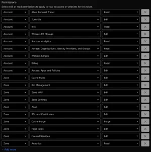

Assuming the settings page still is giving you an error, but you are able to verify the token with that curl command at the same time, the only other thing I can think of would be if certain individual API calls were having an issue. Maybe double/triple check your API token permissions? Maybe one of the permissions it needs was removed or edited. You need exactly these permissions:
Anything missing or anything with the wrong permission (like Read instead of Edit) will be problems.
