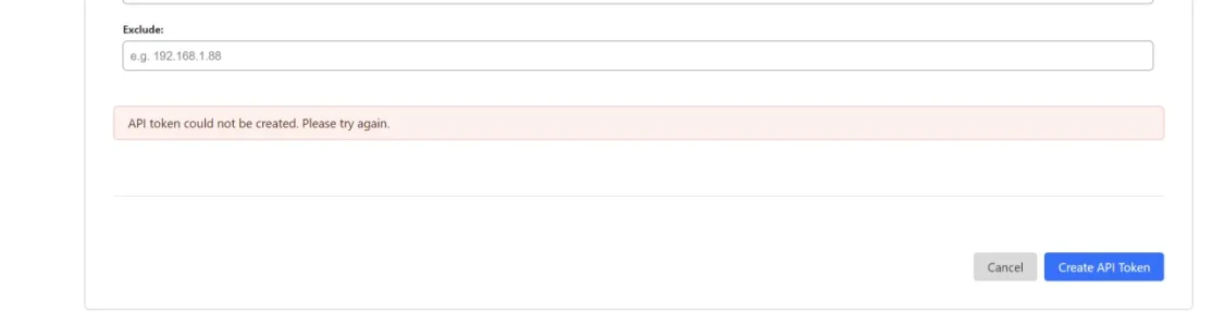

Also when I try to create an API I get the following error:
@digitalpoint is this something you've experienced? Communty support sucks and they haven't help me at all to figure out if there is a blocking on my account or whatever

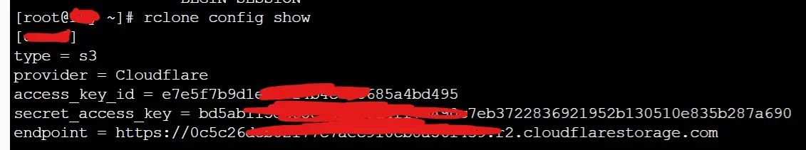

  • Can use R2 for storage without site being a domain/zone in Cloudflare
  • Made change to XenForo's attachment data entity to be more efficient (normally XenForo checks if an attachment exists before making an additional call to actually get it). This will reduce an API call for every attachment view because we don't need to check if the attachment exists (we know it does already because we have a record of it in attachment data).
  • Added new option: Use presigned URLs for...
Thanks Shawn. This is awesome!
I meant to do it awhile ago, got frustrated with building my own signing method to do it, shelved it for a bit and then forgot to go back and revisit it. Ran across @Chris D talking about it over here and remembered this morning I should finish it...
A fresh look at what I was doing wrong before was useful today and I got it working. :)
