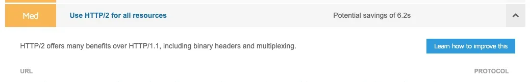

For the pre-signed URLs, Cloudflare isn't using HTTP/2 so it's reporting in GTMETRIX has quite a performance hit

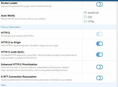

Isn't that a separate issue, and a toggle-able setting in /admin.php?cloudflare/? Mine is "on" but greyed out, and I have pre-signed URLs enabled, and ran a check of my forum with gtmetrix and didn't get that same notice that you did.
That's for your own URL, when they are pre-signed, they use a Cloudflare domain, so I don't think that option is related.
FWIW, I suspect it has something to do with R2 using an S3 compatible API (the API endpoint is used not only “traditional” API calls, but also the presigned URL requests). And Amazon’s S3 API doesn’t support HTTP/2 or HTTP/3 either.
Hopefully they do upgrade that at some point and don’t stay rooted in limitations of S3.
