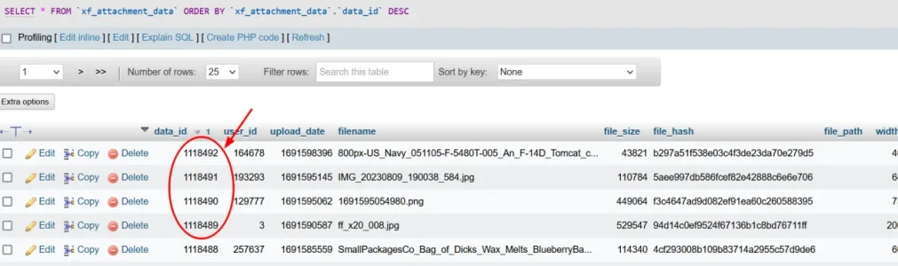

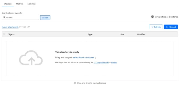

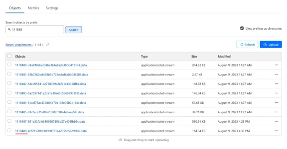

1. After the activation of the r2 storage , new attachments are working fine, but I can not find them on R2 :) , they are not on the server itself so they are being uploaded in R2 but not visible in the right folder. Does it take some time?! (images below)
2. Old attachment images (thumbs in data folder) are loading fine but the old attachment itself (the .data file) is not loading, although the file is already in R2 storage. (error below happens)
What have I done wrong?
Check the info about rclone uploading. More specifically, the part where the file structure needs to match (see this post). From the looks of your screenshots, you don't have "attachments" in the path on the R2 side (newly uploaded things will have it which is why those work, but old ones don't... they don't have the correct path).

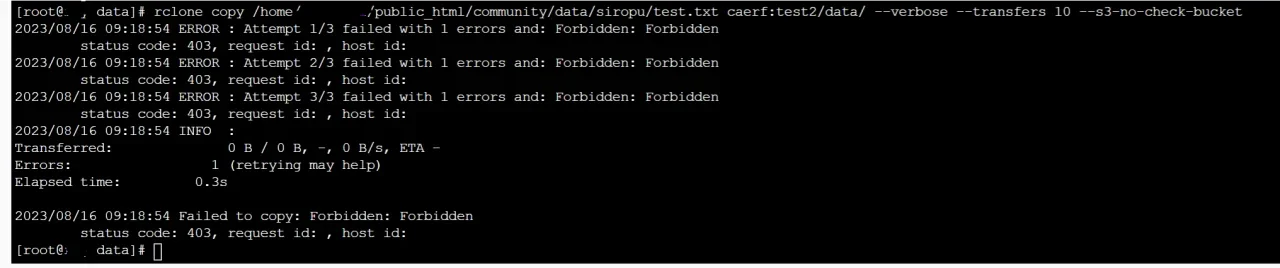

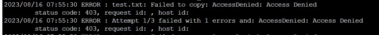

Did anyone had a similar issue using rclone?
The command looks OK:
rclone copy /home/user/public_html/test.txt user:test2/ --verbose --transfers 10

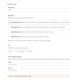

Also if I want to create a new API, I get the following error:
Could be my account limited? It doesn't make any sense
