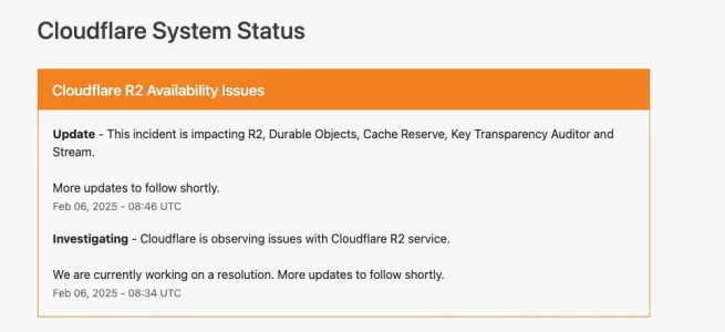

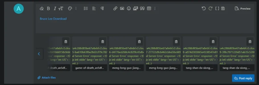

Not sure if the add-on related, but I'm on XF 2.2.17 and I used 1.8.x version quite a while. I've many uploads daily, including myself and it worked fine. Today I've upgraded to the latest version, and since then when I try to upload things I get a 500 server error – what could have changed this from add-on update only? No server changes were made during this time in between upgrades
Server error: DELETE https://somelink.data resulted in a 500 Internal Server Error response:
@Moshe1010
I have the exact same error! I came here to state this (simply trying to upload a jpg attachment) and see if there is a solution. Using XFMG 2.3.3 and was working perfectly.

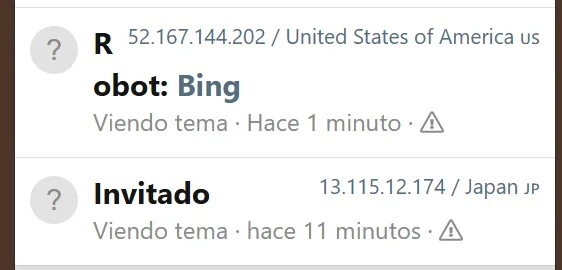

This didn't resolve the missing flags for me sadly, even with all requirements enabled.
Is it possible to display flags instead of letters?
For example, create a folder on the server with flags, where each flag has a name like us.png, ca.png, etc.
Then, simply modify the template to insert an image using the country code instead of letters?
Yes, if you use something other than Windows it already works that way. Windows doesn’t support Unicode flags.

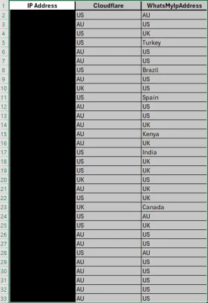

@bzcomputers do you have some example IP addresses where there are differences and also tell us what location is being reported by each system?
I do. The site has its majority of users from the US, UK, AUS, and CA in that order. Better than 50% of country locations reported by whatsmyipaddress.com conflict with what is generated by this app and comes from Cloudflare. Which before today I thought were both good sources of IP data, now I must question that.
I can provide IP data privately just don't want to publicly post any possible user specific data like that. I have a feeling for any busy sites with international users and this app installed can go to the Admin CP -> Users -> Latest Members -> select a member -> IP addresses: there you will see the IP represented with Cloudflare's geolocation country under it. Then click on the hyperlinked IP address to get whatsmyipaddress.com geolocation details. For me, when checking earlier today, the location conflicted by completely different countries more than 50% of the time over the 20 latest members. Just checked again and I would say it's 30% conflict over a batch of 20 different new users. I can put together a spreadsheet for you with about 50 examples from today if it would be useful.
Edit: Latest 80 users with 32 IP geo location conflicts.
Thanks - I checked the IP addresses you sent me against my paid Maxmind database (more accurate than the free one) and the locations concur with the WhatsMyIpAddress list you've given - other than the Kenya one which is detected as a DataCamp server which Maxmind says is in Romania and the one from India which is listed as "Kings College London" - I think those two are likely to be recently re-allocated IP ranges where the databases haven't been updated yet.
I then started testing the IP addresses individually using the "IP address details" provided by @digitalpoint 's Cloudflare addon (Admin CP > Cloudflare > Tools > IP address details) ... and the results it was giving me do correspond to the same addresses as WhatsMyIpAddress. Have you tried this tool yourself? I'd be curious to see whether it concurs?
So I'm not quite sure what's going on there - it seems to me that everything is showing the correct information, except for your "Cloudflare" list in your table.
I'll check what my sites are displaying and whether it seems accurate.
