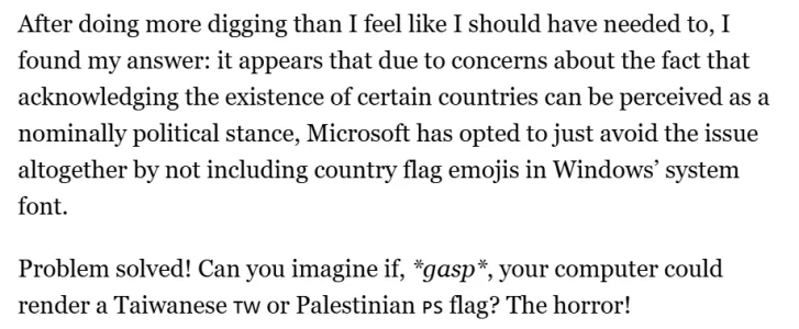

Yep… Windows doesn’t support flag emojis.
Just to clarify things - it´s showing flags with latest Firefox on Win11 - Chrome and Edge don´t do it.
With FF I´m seeing " <div data-template-name="public:geo_macros::flag" class="country at" title="Austria"></div>" while Chome shows " <div class="country de" title="Germany"></div>" and so does Edge.

There are Chrome and Edge extensions that can add in the country flags. I've tried to substitute the Windows emoji font in the past, but MS has it locked down in a way that any of the hacks that worked in the past no longer work. I don't know why we can't just have the ability to replace their emoji font with one of our own, and leave it up to us to try to figure out why flags don't work.
