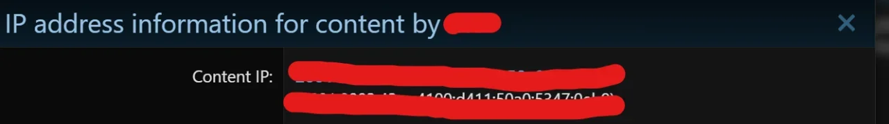

No... the IP address for the post itself. Go to one of the posts that happened after you enabled it all, and make sure you have the IP address logged for it (normal XenForo function where you can see the IP of the post).
Thanks for hanging in there... I assume you mean here:
I click on IP and get this:
Could it be a Redis conflict?
I doubt it, but it's possible (not a conflict so much as Redis not working as expected). Specifically, if you are using a caching mechanism (like Redis) to read options from, if Redis isn't returning the option value for whatever reason it would be a problem. You could toggle Log IP address locations option on/off to force XenForo to write the value to Redis again. That's probably not what's going on, but it's really simple to try.
What I think is more likely, is that your server is configured in a non-standard way as far as IP addresses. If you go to your admin area, and go to the following URI: admin.php?tools/phpinfo, go down to the PHP Variables section. There is some basic logic about when it tries to log the location...
  1. The option to log it needs to be enabled (duh).
  2. The $_SERVER['REMOTE_ADDR'] variable needs to be set (can see it on the PHP info page).
  3. The $_SERVER['REMOTE_ADDR'] variables needs to match what was just written/logged to the xf_ip table.
So a couple things come to mind... if your setup isn't logging the exact right IP address it wouldn't work (for example if you have something that is anonymizing the last part of the IP address). This could be various proxy headers that could be interfering as well.

  1. The $_SERVER['REMOTE_ADDR'] variable needs to be set (can see it on the PHP info page).
  2. The $_SERVER['REMOTE_ADDR'] variables needs to match what was just written/logged to the xf_ip table.
The two ip addresses are different. Is it because I have Proxy enabled in Cloudflare?
Also, toggling the setting didn't change anything.
Ya... it's normal. And ya, that's what the issue is because I'm stupid and forgot about that "what if". It's easy enough to fix (already been fixed on this side).

It seems to have worked. Is is supposed to just have the words or display a flag?
