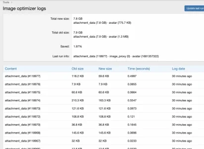

What exactly does that addon not do that you are trying to do?
It optimizes all images which stored in XenForo to lower size and do not loss quality.
So, in my case it went crazy once I installed your addon. The latest attachment id uploaded to R2 is id #1157917 while the addon is optimizing fake ids because when I look for those attachment ids none of them exist (in fact, it says the latest attachment is #118977:
Sounds like a question for the author of that addon. I don’t know anything about it myself. If that addon isn’t using XenForo’s abstracted file system, it’s not going to work properly in all likelihood. Basically if the addon is assuming files are in the local filesystem and not using XenForo’s filesystem which handles that, it’s going to be an issue.
But again, I don’t know anything about that addon or how it works or what it’s trying to do or if it’s doing whatever it does “properly” (by using XenForo’s abstracted filesystem).
If you have a question specific to the Cloudflare addon, I should be able to help.

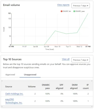

So I didn't particularly want to completely rebuild what Cloudflare already has, so it's not a full-blown interface for DMARC management, but I did incorporate what seems to be the most important part (the table of unapproved DMARC sources). The chart is nice fluff, but it doesn't really do a whole lot for you as far as as tracking things down. Maybe I'll revisit it when it's out of beta, but for now the addon will give you unapproved DMARC sources for the last 14 days (for whatever reason, Cloudflare's reporting engine seems to get inaccurate if you go with 30 days (looks like they are sampling the data rather than using the exact data on the 30 day report). And if someone wants more than that, there's a deep link direct into your dashboard to get at the other stuff.
Since it hasn't been in place for 30 days yet, the data may be doing some odd things. I do find the email volume numbers useful for tracking also.

There's a few screenshots in this thread:

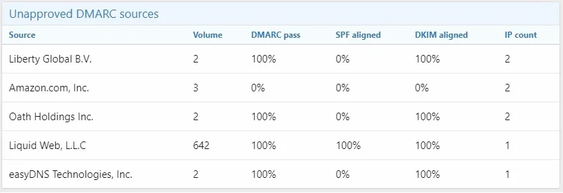

1. DMARK Management: Unapproved DMARC Sources also includes Approved Sources in list
Hmmm... it appears to be working okay for my zones, but I do see something that might affect it, but I don't have a way to test it since it's working for me. If you go to the DigitalPoint\Cloudflare\Api\Advanced.php file, inside the getGraphQLDmarcSources method, change this:

...does that fix it for you in your setup?
Adding that line of code did not make a difference for me. I even went to Cloudflare and toggled the approved source back to unapproved and approved again, still no change in list shown in XF.

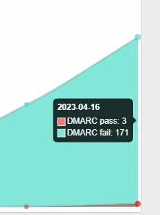

One other small bug...the floating bubble on the chart has the pass/fail labels backwords
Are you seeing them differentiated in the Cloudflare dashboard? As far as I can tell, I'm using the same query that the dashboard is using and it's showing exactly the same as the Cloudflare dashboard for me.
Ya, I already fixed that for the next version.

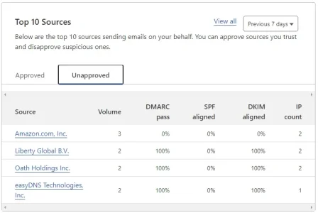

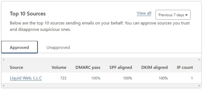

Yes.
Showing on Cloudflare...
Versus showing in XenForo...
I figured out what's going on... Cloudflare is doing things slightly differently on different domains for some reason. I noticed it when comparing two of my own domains and was able to track it down and fix it for any zone (hopefully). The sorting is worked out as well. So will be part of the next release.
